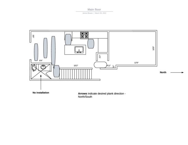

      I attaching a drawing as it is easier to see what I mean. Overall it’s more the framers didn’t put the crown right-side up on the joists. The worst spot is the fridge area which is at least 1/4″ after that it’s the landings near the main floor entrance and near the washroom but those areas are 3/16 or less. The dark areas are the dips.
      I watched your video and am being cautious as I don’t want to mess it up but I do have some concrete experience including troweling and screed work so I really just need to know if my approach to solving this problem is a good idea.
      Thanks Joe.
    March 28, 2022 at 2:18 pm
    yes, screeding these areas would be best.

    Well i’ve done a decent job on the main floor prep. It’s not perfect but it is a lot better than it was. Now I am right on the verge of starting. I have watched the blueprint and followed your direction about where to start and I have some thoughts:
    • The hallway near the closet is 36 1/4 inches wide, the middle is 18 1/8 inches (which was to be the starting point) and the planks are 9 inches wide. if i start from that line, we get into some situations in the kitchen that i don’t like – there would be too many small strips and lot of cuts in the dishwasher area.
    • The hallway near the island is 51 inches wide – if we build our centre line from that, we get a pretty nice layout and everything is very easy from there. The only issue with my idea is the stoop where step onto the main floor. I don’t really understand how to end the plank there and use an overlapping stair nose. The grey coloured area is thin set so I’m thinking I will have to remove some of the thin set and put some of those strips you showed in a video for stair nosing and how to build it up before attaching the overlapping stair nose.
