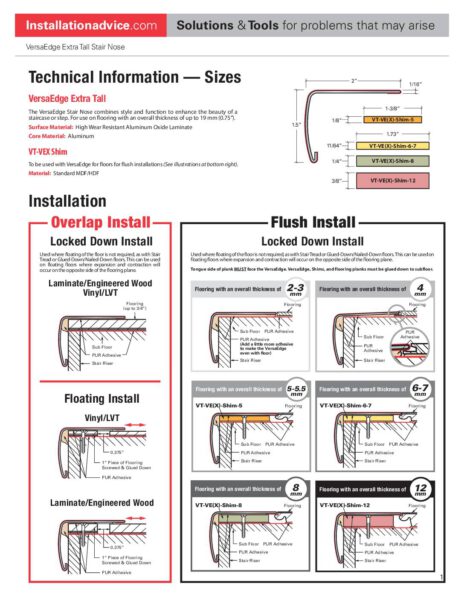

      As of now i plan to use aluminum stair nose called Versatrim (1.5″x2.0″) unless I find something better and more applicable.
      I like the idea of installing the riser on top of the tread.. that makes sense and will give it a clean look when its done. the tread are wider than 7″ (the size of my plank flooring) so i will need to use two planks per tread. the riser is under 6″ so one plank will do.
      Am I correct in my thought of just gluing the plank on the tread and riser and then gluing the stairnose in place? attached is the install instructions for the product. I would be doing the overlap lock down install.. right???

    Yes, I would glue the tread and riser and use the overlap technique using that nosing. When are you going to start the steps?
