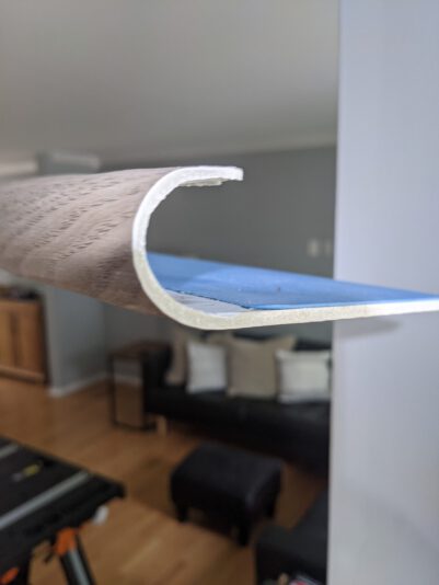

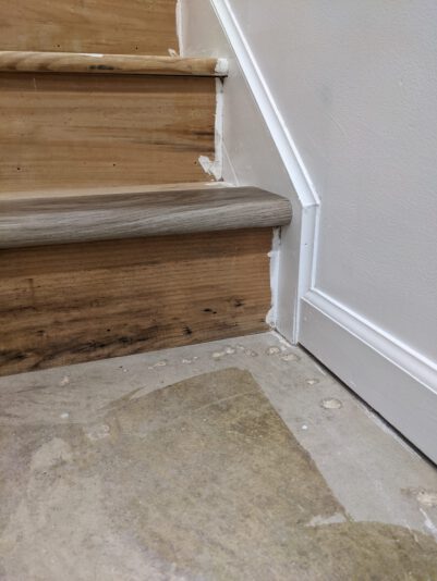

    for the stairs a I made a jig from a 4×4 and took 1/2 the thickness of the backside of the board with a hand router and heated the plank with a heat gun and formed a perfect bullnose.
