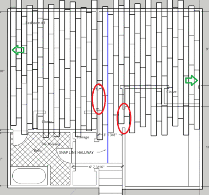

Hi Joe, I did some more simulations and it seems that I found the sweetspot and hit the jackpot! Or not. I am able to hit both doorways (red) and I get a 3/8″ gap on both sides (green). Is that too risky to have that gap covered by the baseboard? I was not planning on using quarter round, just the baseboards. Or should I move the line (blue) a couple of inches to either side?
