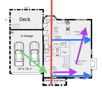

    Here is some more info. I did some math using the equations in your video. The numbers actually worked out pretty nicely and I think I can go by this. Here are the numbers I came up with:
    10 Planks = 71″
    1 Plank = 7 1/8″ (3 9/16″ Half); Tongue 3/16″
    Hallway Width: 36 1/2″ /2 = 18 1/4″
    *It turns out if I place the seam directly in the middle I get each end piece in the hallway an equal width. I measured 18 1/4″ in two spots and lined them up with a laser level. I then measured the opposite side of the house in two locations to the laser line and the distances were 252 3/4″ and 252 1/2″. I can’t ask for more than that.
    The distance from the laser line to the left wall measured 58 1/2″ so I measured that up against the 10 planks to a seam and that is my first piece, correct?
    The arrow in the attached pic are as follows:
    Red Line = Laser line in hallway at 18 1/4″
    Blue Lines = Distance to opposite wall = 252 3/4″ and 252 1/2″
    Green Line = Start point
    Purple Lines = Direction of floor laying
    Would really appreciate your thoughts.
