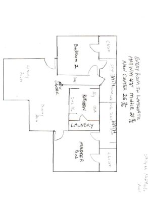

Here is a link to the screencast I made for you.
Hi Joe I watched your reply 5 times. I then split the video into 3 working sections. (1) Bed/Closet/bath/hall. (2) Hall/bath/kitchen/laundry. (3) Living room/MB/bath/closet. Yes I’ve taken notes on the sections mentioned. Forgot to say all doors are 35″w and Br is 11×11, closet 6×5. Mbr 13×11 closet 6×5. Using 12mm water resistant Laminate plank from LL. 7.5w x 50.5.
Thanks so much to you and your University, with these tools I can succeed. God Bless you and your family.
Hi Joe
So, I just get into the door way of bedroom half the board in the doorway and half against bedroom wall under casing. You said the outside wall should be straight. So, I measure from the RH OSW just enough to be in the center of the closet (1) snap line from closet to bottom OSW.
(2) measure over from snapped line to be in center of Bathroom door. Run what line from the bottom FWD OSW to the Bath room cabinet. And just lay boards from left to right into bath and closet. Am I correct.
Yes that sounds correct. If you want to call me Howard to go over some things you certainly can. My number is 218-256-8080
