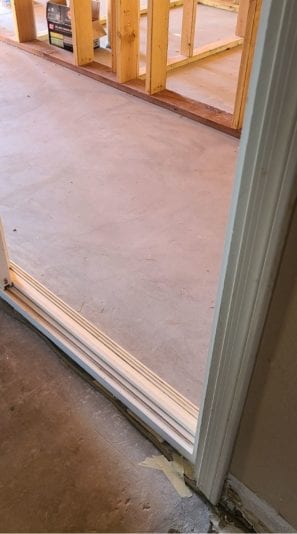

    We decided to use some equity in our home to build a master bedroom (plus some) addition on our home. We are about 1/2 way finished with construction. We live in Mesa, AZ (suburb of Phoenix) so it is really hot this time of year. We don’t have a basement… this home was built on top of a concrete slab, as is the new addition.

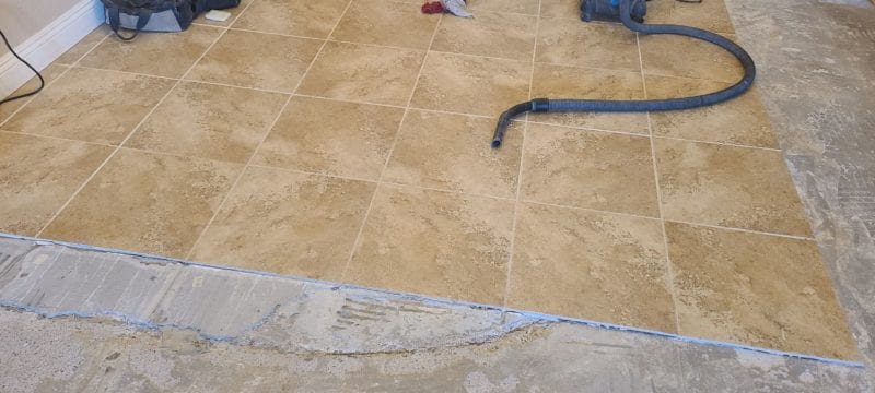

    I’ve been tearing up the old ceramic tile the last few weeks. I’ve got a decent amount of prep work ahead of me. The last area of tile that I need to pull up goes over the old sunken living room that was filled in by the previous owners. I saved that for last due to the amount of grinding I’m going to have to do once the tile is up.
    So, at this point in the project… I’m trying to figure out how I’m going to level out this floor, and repair the cracks. One thing that worries me about the products I’ve been reading about is that you are supposed to use COLD water with the mix. I wouldn’t say that our tap water is cold during the summer… maybe in October. That said, construction here doesn’t stop in the summer… so I’m guessing lukewarm water must be OK.

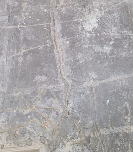

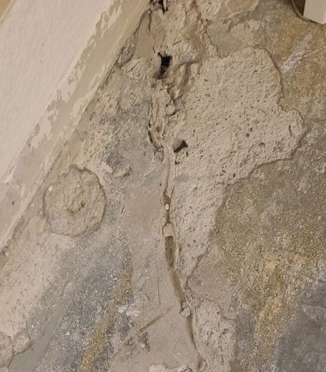

      Today I grabbed a nice straight 2×4 and went around the floor. Unfortunately I can’t find any area longer than 2 feet where the 2×4 doesn’t have a gap. This home is 45 years old, so I guess I shouldn’t have been surprised by this. The only place the 2×4 sits nicely along the floor is on the slab in the new addition. I don’t need to make a decision which way to go (regarding leveling the floor) until I come back from this upcoming vacation… so I think I’ll pray about it until I return.

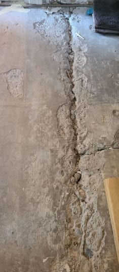

      Regardless which way I go on the leveling, I definitely plan to begin working on the cracks first. You mentioned using membrane and cloth, but I’m not sure how to go about this. One video I watched on YouTube suggested:
      1. cleaning up the crack with a crack chaser blade on my angle grinder
      2. make sure the crack is super clean with no loose debris
      3. fill the bottom of the crack with something compressible
      4. patch over the top
      Does that sound about right to you? Do you have any videos already made on treating cracks in a concrete slab, or have any suggestions on a video I can reference where the person is actually doing things properly?

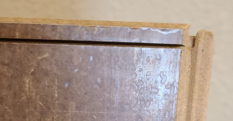

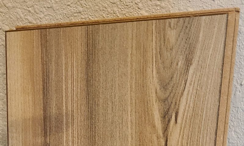

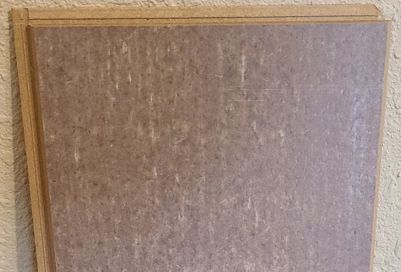

      I’ve added some photos of the planks I purchased. I wasn’t sure if you wanted an up close view of the ends… or if you wanted a photo of the whole plank. I went with the former, so let me know if you need to see something else.

      Correct. It was filled in when this house was flipped before I purchased it. You can see in one of the first pictures I posted to this thread the difference between the old slab and where the sunken living room was filled in. It is the photo with the tile sitting on top of curved lighter gray area of the floor. I had to grind the thin-set off that area after pulling up the tile, because the thin-set couldn’t be scraped off that area like I was able to do on the rest of the old concrete slab.
      I am finally back from vacation, and I’m starting to get ready to move forward with repairing the cracks in the floor. Once the cracks are repaired, I have decided to move forward with using the self leveler to take care of all the other chips and tiny cracks in the old concrete slab.
      Question about the self leveler:
      With the addition to our home, the kitchen has been expanded (approx 5×10 area). I will use the self leveler in the old kitchen area since there are so many dips, chips & tiny cracks in the old concrete slab there. I was wondering if you think it would be OK to thin the self leveler out over the new concrete slab of the addition the further I get from the old kitchen? The kitchen area is what leads to all the rest of the new addition. I’d rather avoid using the self leveler in the new addition since the concrete slab there is so pristine. Seems like I could feather into the new addition, instead of spending the extra money on self leveler for that whole area as well.
