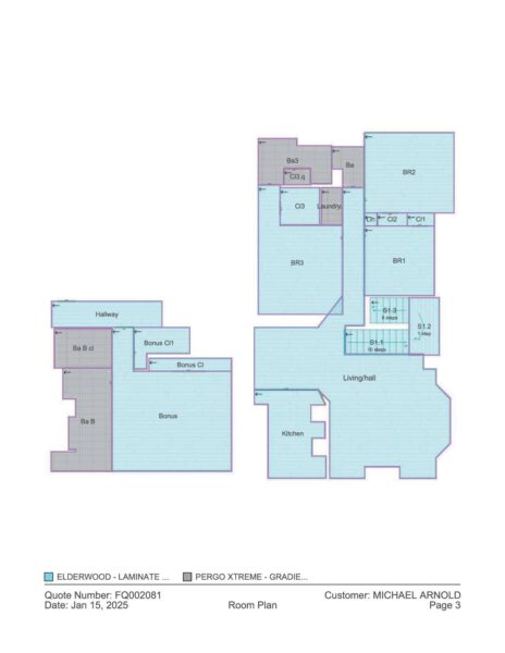

Posted by Michael on February 11, 2025 at 9:13 pmHere is my floor plan. There aren’t any dimensions here as it is the one provided by the company that came out to measure the square footage to find out how much product is needed. I can do some measurements and add them here as we get moving but this is the start.

I was just looking closer at the copy of the floor plans on my computer and noticed something I didn’t notice on the printed version. The planks run east to west, where I had in mind the planks would run north to south. This would give me the house layout based on the planks running longways down the main hall and the bedrooms. The rest of the house would run the same way, with the shorter downstairs hallway laid with short planks.
I look forward to your thoughts.

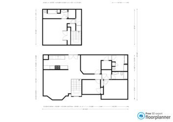

As I mentioned in my video, last night, I gave myself the homework to use the floor planner site to get a better idea of how the layout should look. Hopefully, this will work. And I just realized that I forgot one more door at the end of the hallway on the lower level. it is on the right side at the far end of the hallway.

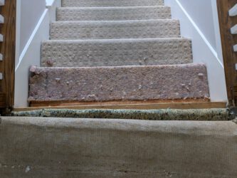

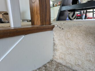

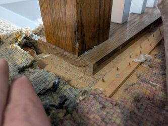

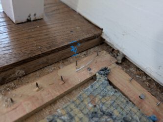

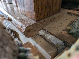

Other than that there are some things I’m going to have to work out. Like Brett in his project, I also have a banister, an almost identical one in fact. However, I am using the same laminate on the stairs so that will be fun. Here are some pictures of the banister area as that may also play into the decision on how to lay the plank. I pulled up some of the carpet to get an idea of what options. One thought was that I could use a multi-tool and undercut the banister and have the plank run under. I have pulled the carpet away as shown in the one picture and I have 3/4 inch base on the banister the full length. However, I’m now sure how well that will work at the top of the stairs.

You are keeping me moving Joe and that is a good thing. Hopefully, you can see what you need from these pictures. The one with the new plan next to the base doesn’t have the underlayment under it, but it gives a good idea of what we have left, and it looks like that is a uniform depth the full length and with the corner banister area as well. I think the biggest thing to be determined is how it will work with the tread/flush mount pieces that we have/will have for the stairs.
I haven’t ripped it all out yet to get a for sure since I plan to start with the downstairs first. A good place to start as it is the easiest layout and a good way to get into the groove.
As for direction, my wife’s first view at the virtual images, she likes the look of the east west. And it makes sense from your thoughts of starting the master and working around with the only big area working backward being the dining and kitchen.
I agree that it does make sense to work as you said from the banister to the other wall as it gives us the plank under the banister.

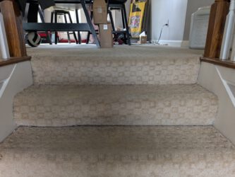

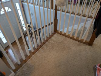

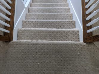

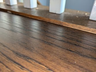

Here are some pics of the front view of the top step.

Unfortunately, they don’t have a full tread with this plank we selected. What we have ordered is the flush mount for the treads locking into our normal planks. I did watch that video you shared a few weeks ago talking about not using a flush mount on the top tread and using the overlap, at least on the top. I don’t have one of those ordered right now, and the flooring store we purchased from said that they use the flush mount on the top all the time. But, I’m open to changing things up. Here are some more pics of the stairs.
One thing is that the tread currently sticks out around 1/4″ from the riser. I would trim that flush and then install the white-painted riser up to the top so the overlap flush mount would cover it cleanly. The good thing is we have time to talk about what to do here as I work downstairs and complete those rooms first.

I realized as you were going through the walk-through that I never took into account on the plans the way the stairs come up and block having a clear view from the hall all the way down through the house. But if I follow the logic well enough I could do the red line for the hallway, but use the blue line to check and set up the layout for the rest of the house.
As for the downstairs, I think it would make the most sense to start in the northwest corner running to the southeast corner as it would only have me working backward in the two blue-marked areas. I would use the same logic as you demonstrated in the upstairs to make sure I account for the three doorways and how they line up keeping in mind the right transition placement to the LVP in the bathroom.
I think the plan is to have them run east to west as well in a random pattern. Does that room make the most sense to start up in the NE corner where the toilet is? Obviously, the toilet won’t be there during the floor installation.
I understand the concept of the undercut. We will definitely be talking more as we get there.
