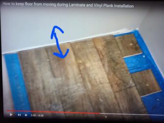

      a screenshot from your video. How do you prevent floor moving in the arrow direction? I watch the video twice and did not see any spacers used.
      Also, I discovered my plywood subfloor formed peaks in places where two or three panels meet, so I am belt-sanding those to flatten the floor. Any issue/advise with this approach?
    February 14, 2023 at 10:11 am
    Those spacers you shared will work there. If I need to hit the plank in that direction I slide a pry bar in between the wall and the plank.

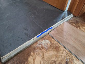

    Joe, I’ve opened up transition to the second bathroom. I guess I should cut the cement board flush with the tiles?
    The heigh difference between the tile and my LVP plank is different between the bathrooms:
    3/4 in and 1/2 in

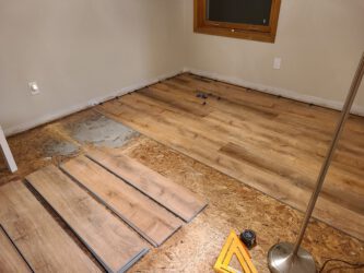

    Joe, this is what I installed today in like 4 hours:)
    I started with the full-size plank in the left corner as in this way I’ll have almost full-size planks at both walls of the bedrooms 2 and 5 and half/size in the hallway. I used Lifeproof spacers I bought in HD and they kept the floor well. In the hall I’ll use your screw method to secure the floor.
    Do you have any hints how to make long cuts straight? I’ll need to make many of these in the hall, and today I was struggling to make short-side cuts straight.
