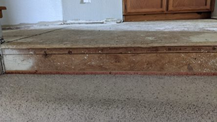

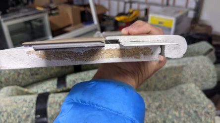

So grateful for the detailed instructions, I just got the carpet all ripped up and got a look at the top stair (attached). I’ve also attached a photo of the stair nosing I have.
The company doesn’t make an overlap stair nosing like you recommend, only this flush one.
However, it looks like it may be possible to shim it up 1/8 inch and make it an overlapping one? what would you recommend for the top step?
