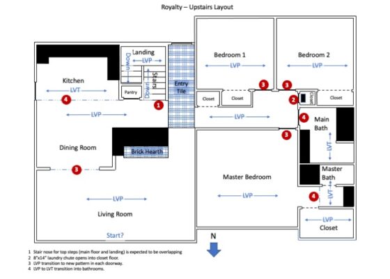

    Joe- Thanks for your fast response. I neglected to include some of the background you need – after all, I’m familiar with what I’m doing ;-). I asked the question about the undercutting the hearth a while back, so this is the same project. I’ve attached the layout from that in case it helps. The partial layout I sent earlier is rotated 90 degrees from the whole upstairs layout.
    In answer to your question about the direction, I need to run the plank east-west in order to make the transitions between living room / dining room & dining room / kitchen work. So that leaves me looking at doing something with the subfloor, and replacing the particle board looks like the route I might need to go.
