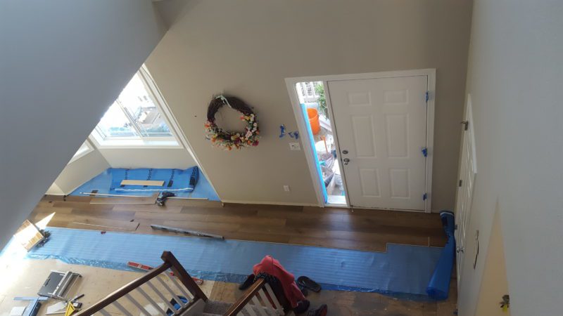

I install my floors left to right, so opposite of video but it is easy to follow and flip in my head. Such great instructions thank you. I cant measure from front door along bathroom to kitchen unfortunately which is also why I like sub floor lines as they go through all spaces consistently. But I will be brave and snap lines too. So many great tips I had not thought of especially seam lines reconnecting around the center area.

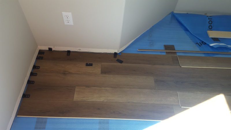

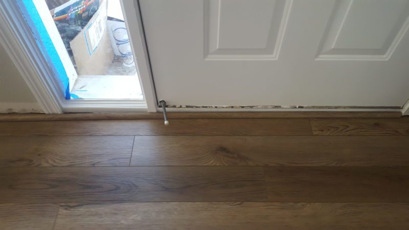

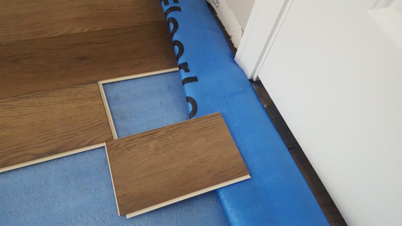

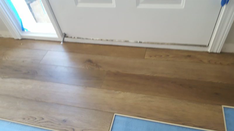

I realized some of my initial post and question did not go through so sorry to ask more after the video. But in the front door I am not sure how to do the quarter round along door and window. So I was wondering if I could “cheat” and have the board go under jam and secure with screws (screw down method you showed) on outside where there is going to be a baseboard. And that way I could skip the quarter round all together there. There is more than a quarter inch of space under there for exansion. And if the answer is no I am ok with that too, but would I just notch the quarter round around the trim piece between window and door? (Pictures are from my first attempt at laying floors but have been removed so I can deal with the hump).
