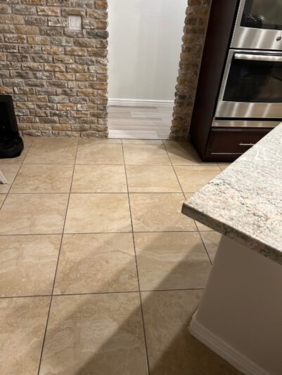

Joe, Since I posted I started taking measurements. Since the wall is staggered around the corner in the back it is hard to get a straight line measurement. I walked off 30 planks from the pic that has the transition (I used the transition to protect the locking system for the next room) and transferred the measurement to where the plank ends in the hallway in pic 2. 10 plank measures 86 5/8 so 30 plank measures 259 7/8. I’m nearly 1/4″ off over 30 plank. If I had watched you videos before I started I think I should have made a line at the far side of the room towards the master around the furthest wall of the kitchen. At this point I think I will still have to chalk the line there but start with a full row of plank at the far end (first pic) as there is 5/8″ plus the raised drywall to compensate the 1/4″ discrepancy just slide the plank under the baseboard a bit more. Your advice is greatly appreciated.
Thanks Again, RC
