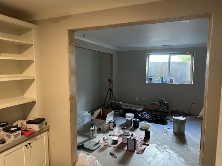

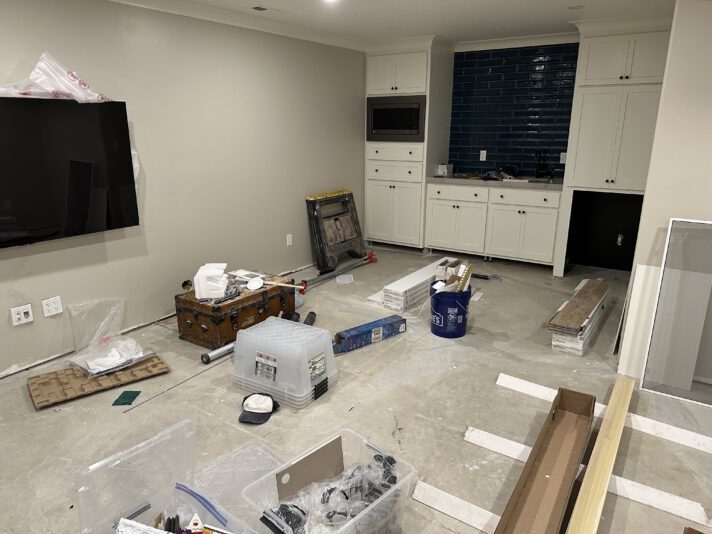

    Sorry for the construction clutter in the photos as I’ve been using these areas to assemble and paint cabinets. The first area photo is looking into the office from the stair landing. The second is looking into the TV room from the hallway.

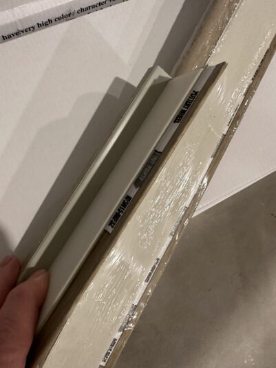

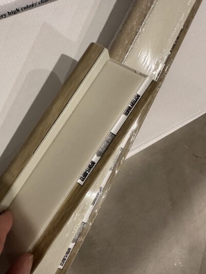

    Pics of bullnose attached. There is a 1 mm loose plastic strip on the bottom side of the bullnose. Unfortunately no instructions were included. I’ve already trimmed the stair bullnose from the treads per your video.

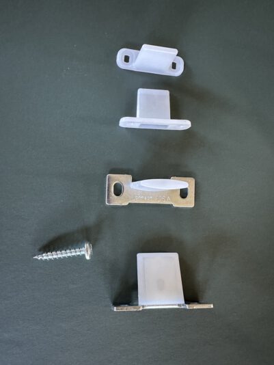

    The bypass door tracking hardware pictures shows two options I have. The hardware on the left in the picture guides the door as the door slides between the two. The other option that I prefer (on right of picture) is a post that rides in a 5/16” slot in the bottom of the door. The easiest install of this option would be to rough up the bottom of the guide and floor and epoxy these to the floor. I include the provided installation screw in the picture, but this is for wood.
