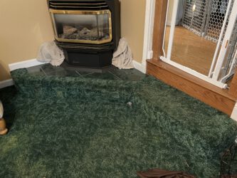

I had a question/issue with the stair. I ordered the stair nose that came from the manufacturer. It’s 4 3/8th” wide and has a groove in it. That goes into the tongue part of the plank. So if I were to instal it on the two stairs that I have I would have to flip the tongue and groove direction you did in the blueprint (min 35). The “tongue” of the plank actually has a little bit of the core sticking out to go into the groove of the stair piece.
Also, I’ve looked at your video on stairs and you’ve said you don’t like the flush stair nose pieces. What do I do if that’s what the manufacturer provided?
First image is a close up of the tongue side of the plank. Second is the full plank. Third is of the Stair Nose, fourth is of where I will be installing on the stairs. Everything you see there will be plank, above and below.
